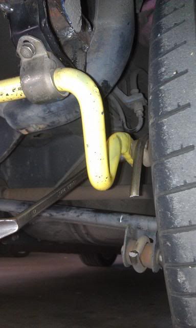

One thing you may want to keep an eye on is the two rear center sway bar mounts where they join the chassis of the car. The extra strength of the SB can cause the mounts to snap. This causes a terrible banging noise that will freak you out when they snap off. This occured to my blue one during some spirited mountain driving. One thing that may be part of the cause, apart from the age of the mounts is the fact that the car also has King Low springs fitted. I resolved the issue by welding steel plate on either side of the mount making them similar to the mounts in this add http://www.ebay.com.au/itm/WRX-GC8-Rear ... SwpDdVTsoZ except even stronger as the plate is on both sides. Also best if you can do the front sway asap. Also try to avoid the end links that are like a figure 8 of steel rod...they also snap !!! like this one has
get this sort..

The figure 8 ones are for up front.
What you're first describing is the stout mounts.
Right there. :) The end links are the same as yours too, in fact, are also the same as the ones I put on the 2003. Put it's all good, abeiq said in his first sentence he has the better mounts. :)

They make the figure 8 for rear as well. They are longer than the front ones. I had both that came with the 2 SBs when I bought them and one broke on the front and the back, so I went to the alloy type all round. Had no probs since.
