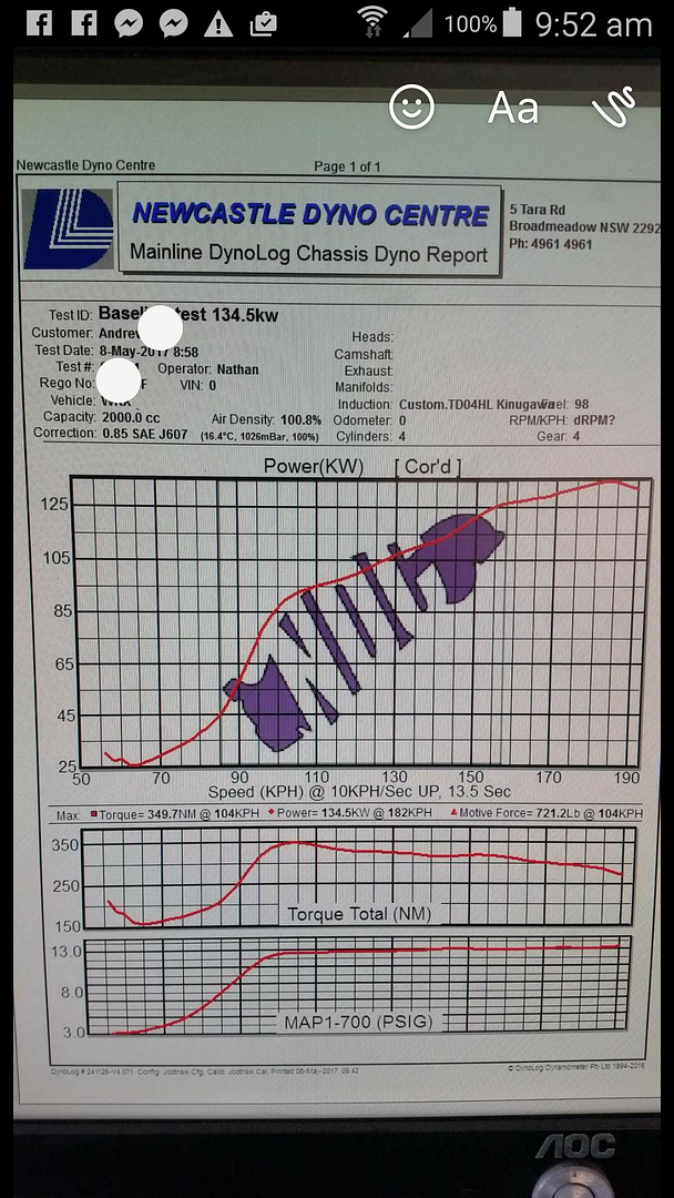

Rightio the baseline run has been done as I dropped the car off, modded on the stock ecu untuned. Here it is. Although its only running 13psi its good to see that it holds that boost all the way to the end.

The chart really does put it where I expected. Runs out of puff @ 100km/h. If you're after more, and really want that sweet here comes the boom hold on thump, get a vf34. :) But it's understandable if you want to keep it closer to stock. Well, it's doing better than stock anyway. :) Good charts anyway, that peak power was in 4th, so that peak In 2nd you'd be flogging to that peak torque easily.

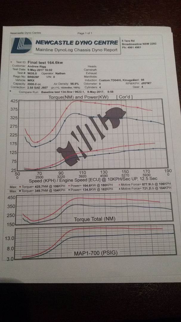

Right now here is the dyno sheet of the completed install and tune. Gained bang on 30kw @ the wheels. Before Tune 134.5 kw @ 13 psi
After Tune 164.5 kw @ 16 psi

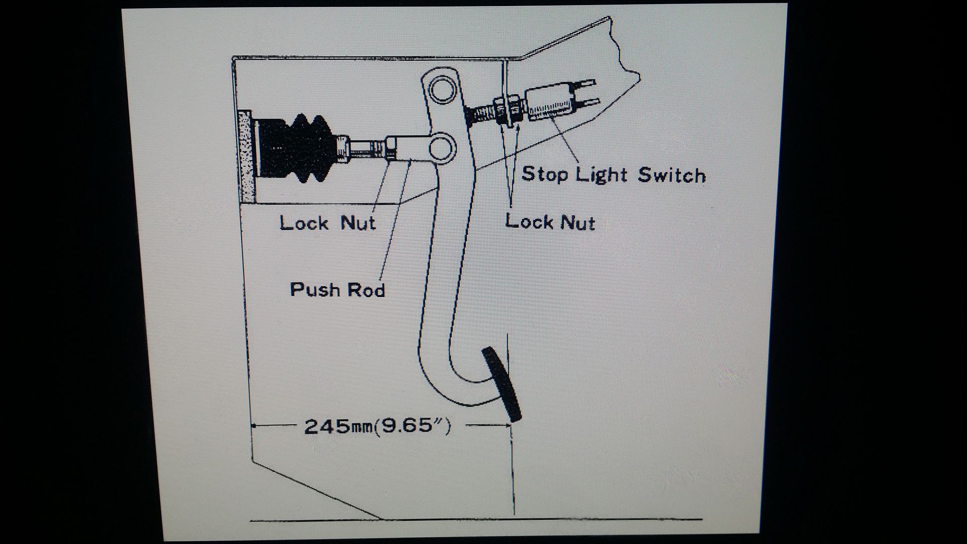

how did you go about the adjustment? im thinking about adjusting mine.
As said above, unless you're doing a full brake service, probably hold off. I have them on my GC8, but i did them when i did the 4 pots and new pads + rotors, made a good difference, but also did a full flush too at the same time.

Here is a brief example pic... disregard the number measurement
You want to be adjusting the lock nut and push rod..... Play around with it until you get a good pedal feel and the brakes are not dragging. note there needs to be some free-play in the pedal. Consult your Subaru Workshop manual for exacting measurements.

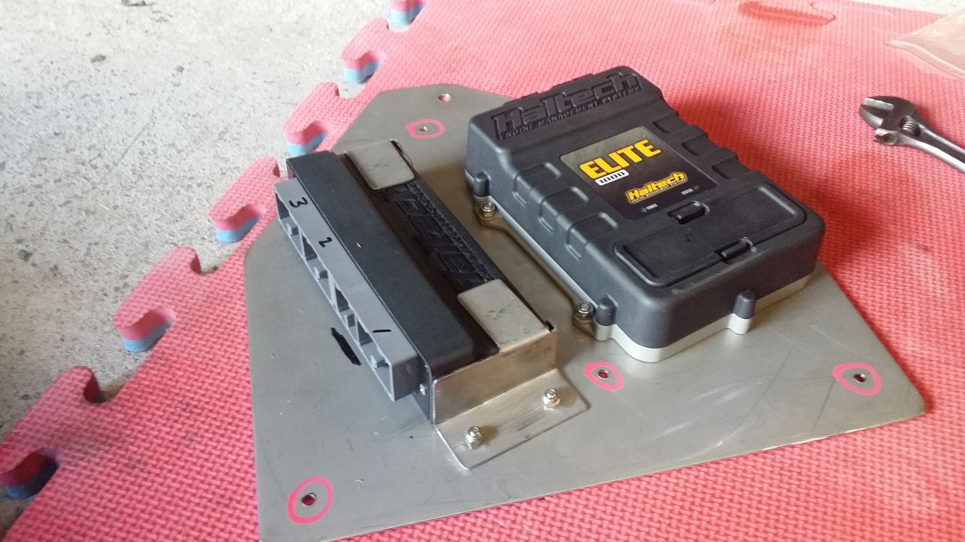

So now im making up a better solution to mounting the ECU and associated bits.

Im in the process of making a custom made mounting plate to try to better arrange the Haltech and other bits.
Here is the start of it.

Ive got a bit more done with the mount by making up these 50mm aluminum spacers. With M5 threads in each end.
And they go in here, so the top can then bolt to it... protecting the parts underneath.
The lid will have a couple of creases / bends in it to help make it stronger.

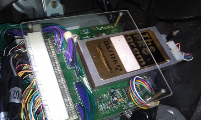

Nice.. I made a similar case out of heavy perspex for one of my daughters wrx ecu...It lives under a steel plate under the carpet so it is safe under there. I was previously just wrapped in bubble wrap...

Nice dude. How are you going to mount the base plate? To the stock cover holes on the car?

Postby Androo26 » Mon Jun 12, 2017 10:53 pm
Its a bit of a sheet fight in there with all the stuff but its much neater than what it was.
