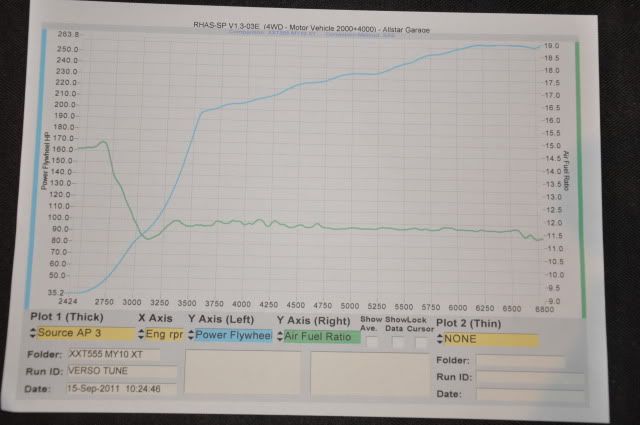

Stock ECU
Verso Flash Tuned by Sean at Allstar Garage 263 whp & 415 Nm
19 psi peak boost at 4200
