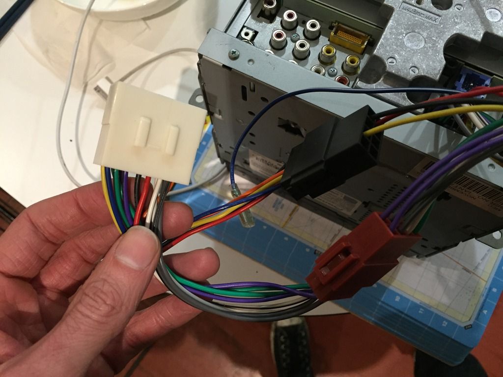

This is my old head unit that I'll be putting in the new car. As you can see all I did was buy a Pioneer to ISO and an ISO to Subaru Aerpro harness.
The existing unit in the STi has not been attached via any plugs or harnesses the ex owner tells me (I'm picking up the car tomorrow) . He says he soldered the wires together. But considering it now, that sounds very strange and I may have misunderstood. Perhaps he meant that he soldered an Alpine male plug onto the cars loom. In which case would I just be able to get a female Alpine to male Pioneer connector?
