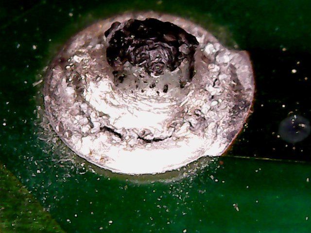

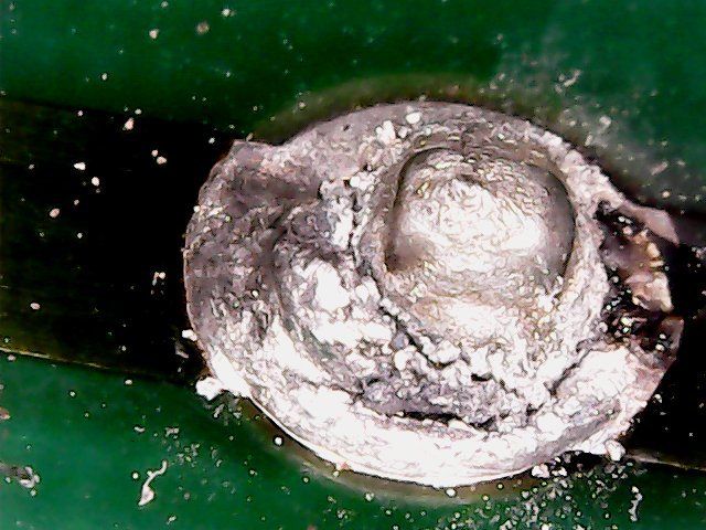

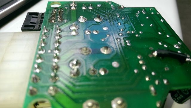

Get it removed.. They are more trouble than they are worth.. The problem is they control a lot of stuff...eg windows get their power via the brant..soo they are subject to heat stress and this causes the main solder joints to crack...This then makes them play up.. Sooner or later you are going to get stuck on the side of the road with a car that has just stopped and wont restart.. We have had all our removed... Everything still works like normal, central locking, flashing lights etc, just no more stupid problems...Cost for removal is around the $175....You could always get someone to resolder the joints.. They are in the brant box and you will see the burnt looking cracked ones straight away.. Here they are magnified .... You can see the cracks quite clearly...
They are the large ones on the PCB in the middle of the pic...
